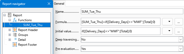

because your using a single table it’s probably best to define a function in report builder.
here is an image of the report builder function you need:
[SUM_Tue_Thu]+if([Delivery_Days]<>"MWF";[Total];0)

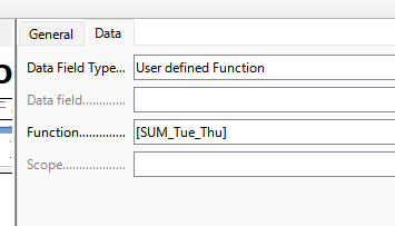

I have created the Function exactly as you show. Then I have defined my report field with Type User defined Function and Function {SUM_Tu_Th].
But no joy. It prints as a blank field on the report. Any thoughts?
I thought perhaps the problem was that the field is in the report header and perhaps the User Function had not been calculated at that point? So just as a test I added the same field to the Footer – and similarly it is blank. Fields are formatted as 1234.57, the default. No conditional print – most of the General Properties are defaulted.

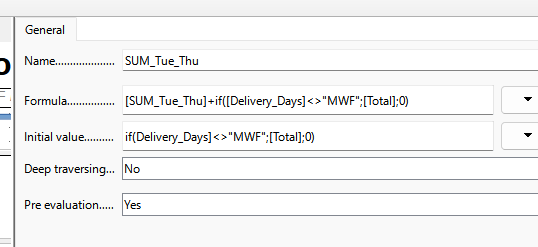

I spotted one difference right away – you specified Pre Evaluation Yes. I changed that but still no joy. I believe I have done exactly as you did:
Prints as blank (not zero, blank).
Do you see what I am missing?
like I said “check your syntax”:
if([Delivery_Days]<>“MWF”;[Total];0)
I have no idea how to debug this stuff. It it were C++ (my primary language) I would stick printf()'s all over the place until I figured out what was going wrong. No idea how to debug this.
Yes!!! Second set of eyes.
There are no error messages I guess. If you get the syntax wrong it just “don’t work.”
Thank you, thank you, thank you.
