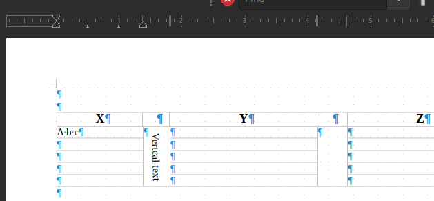

I’m transcribing this document and would like to format this content in Libre writer as it appears in this image. Is this possible? To have no lines in the table and have rotated text? Or maybe a table is the wrong tool to recreate this here. Any suggestions? Thanks so much
Merging and Splitting Cells
Rotating Text
Thank you so much!!! For anyone else who comes across this post as well I discovered how to edit table borders via this post: How to hide and unhide table cell borders
