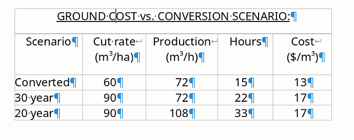

Moving right along. Suggestions implemented gentlemen. Small hitch tho:
My modified ‘Table Heading’ works fine here: underlined, centered and with the space I want underneath.
… but this is the same style:
… it won’t center and it won’t make the vertical space (so I have a paragraph in there for now.
Thoughts?
Do you want the Caption inside the table? Normally it is above the table, the Caption paragraph style includes in the Text Flow tab Keep with next paragraph so it won’t get separated from the table by a page break which might happen if the caption is inside the table and the table can break across rows.
Your Table Heading should be the row starting with Scenario
Is the paragraph style applied? If so and you don’t get the expected results, you have direct formatting. DF always takes precedence over styles. DF is a real nuisance. On sophisticated and long-term updated documents, you must follow a very strict styling methodolgy without DF.
I’m learning as I go. No idea what correct style is yet. I have it in there mostly just to see if I can do it.
Nope, I purged the line. I’m in the habit of doing that automatically now any time there’s trouble.
Not sure what you mean. I applied ‘Table Heading’ as with everywhere else, and everywhere else it’s fine.
I wish it was possible to take a deep look into … well I’m thinking back to WP ‘Reveal Codes’ again … guess that’s not really possible with Styles paradigm, still I wish I could ‘see’ what’s going on.
I deleted the row, recreated it, and now it’s fine. Perhaps that’s a new surgery: if Clear Direct Formatting doesn’t do it, kill the row, recreate and it should be fine. But EarnestAI says it shouldn’t be in there anyway.
