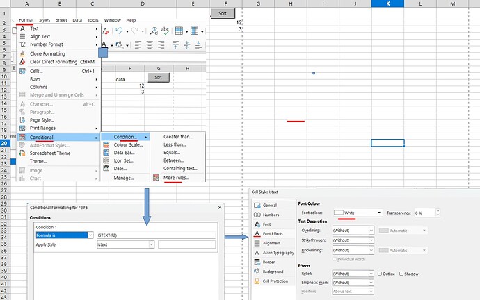

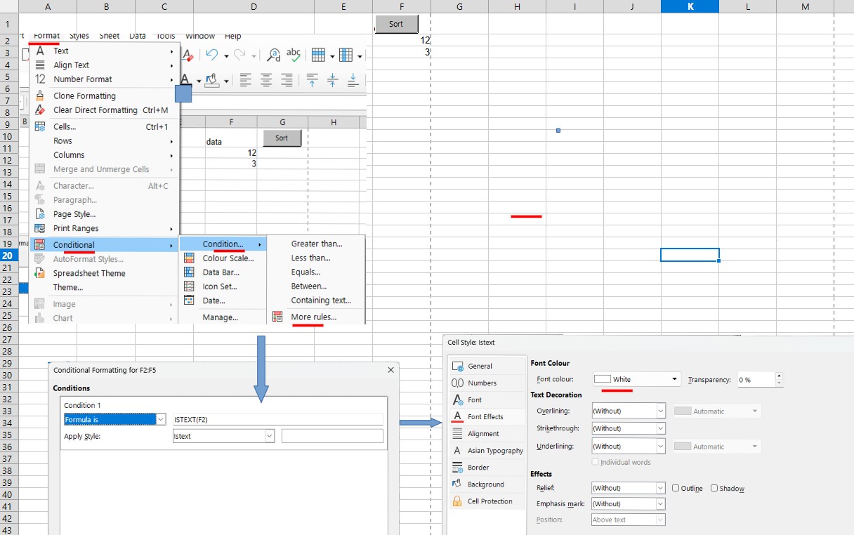

hello
You can use conditionnal format with font color white (if backgroud of cell is white
