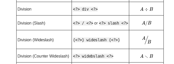

In writer you can use the / character
1/2
1/3
1/12
In Math
