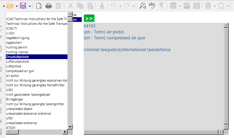

Firebird_LIST_Function.odb (47.0 KB)
Open the embedded form and report.

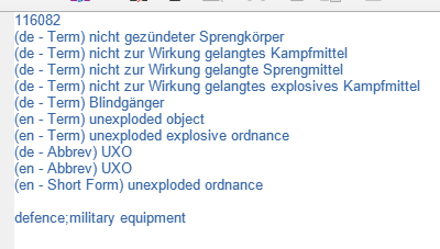

Like this way for #116082?

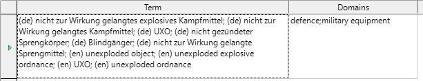

Same form and report grouped by E_ID and L_ID, so you get the concatenated descriptions separated by item ID and language.
Firebird_LIST_Function2.odb (46.9 KB)
Selection via Filter Table
E_ID
Concat_FTM
E_ID + L_CODE
en
Firebird_LIST_Function3.odb (56.5 KB)
Like this?
No links between Forms.
User
  1. inserts the parameters and save them (the record);
  2. >> update the Glossary.
SQL for the concatenation (in 2 queries):
SELECT DISTINCT "TBL"."E_ID" || ASCII_CHAR(10) || LIST( '(' || "TBL"."L_CODE" || ' - ' || "TBL"."T_TYPE" || ') ' || "TBL"."T_TERM", ASCII_CHAR(10)) "Term",
LIST(DISTINCT "TBL"."E_DOMAINS", ASCII_CHAR(10)) "Domains"
FROM "TBL"
JOIN "PARAMETROS" "P" ON "TBL"."E_ID" = "P"."E_ID"
AND "TBL"."L_CODE" = "P"."L_CODE"
WHERE "P"."FLAG" IS TRUE
GROUP BY "TBL"."E_ID"
SELECT "Term" || ASCII_CHAR( 10 ) || ASCII_CHAR( 10 ) || "Domains" "Glossario" FROM "qMultilinhas_Lingua"
