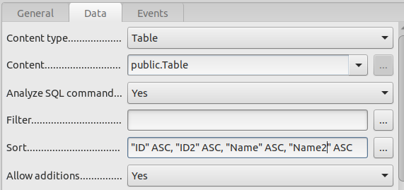

Fortunately your mention of three was a key here. Three is all that is provided for in the dialog but once accepted (and you don’t actually need the dialog at all) you can enter more sort fields on the Sort line itself. Of course you must take care with naming. Here is one with four:
Screenshot at 2022-04-30 19-29-00
Of course you can simple use the query section to create then use here as a data source.
Thank you for the quick responses. The screenshot from ggk showed me exactly what I needed to do. If I’d spent a little more time studying the design process, I would probably have figured it out on my own, but as I said I’m new at this.

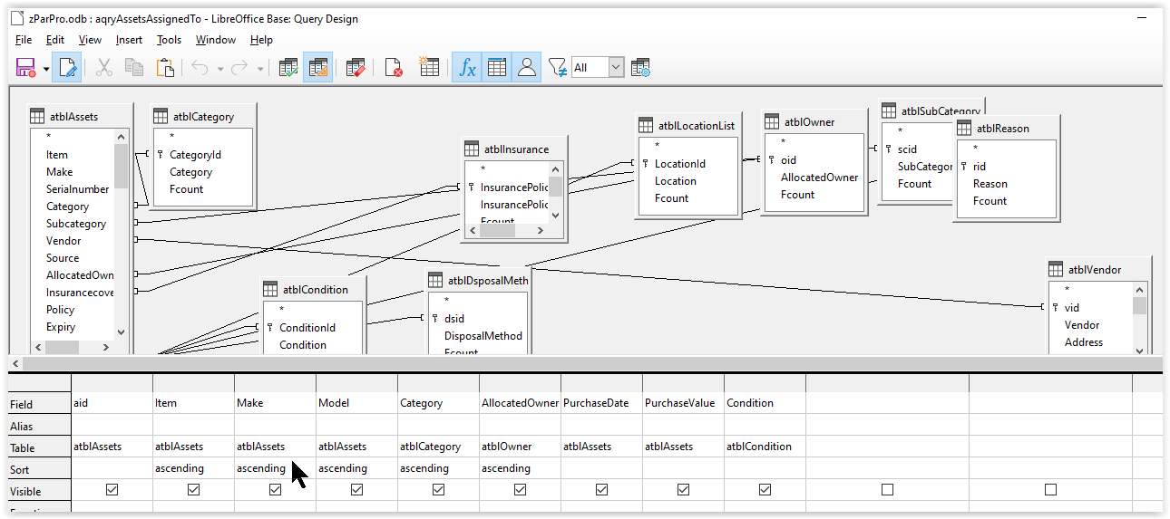

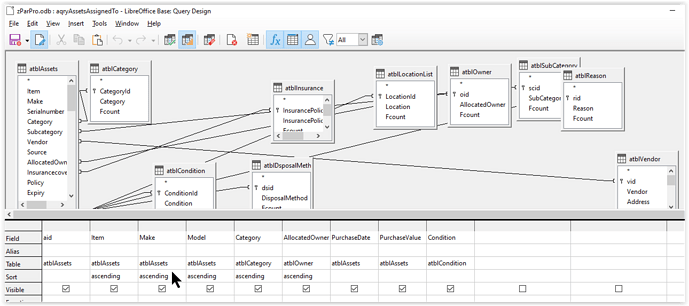

Hi, yes you can sort by as many fields as you wish in the query design view, see screenshot
