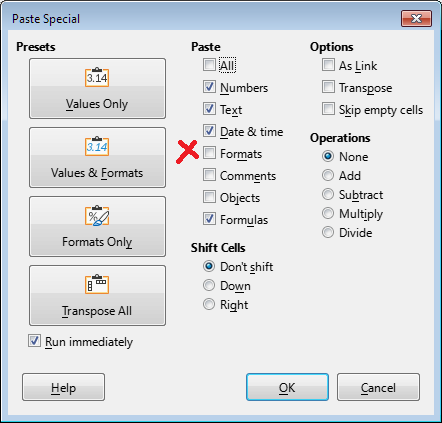

A long time ago, back in the last millennium, this is exactly why office suites started to include the ability to write and run macros. Do you know what exactly you want to do? Do it yourself.
Select any cell below the first row (so that you can press the up arrow a little later), launch the macro recorder. Press the up arrow (as if you were selecting the cell you want to copy), press Ctrl+C, then the down arrow (to return to the cell you want to paste the copy into), press Ctrl+Shift+V to open the Paste Special menu, uncheck the Formats checkbox and press OK. Stop recording the macro, check if it works correctly on different cells and different data. Assign the Ctrl+D key combination to this macro.
