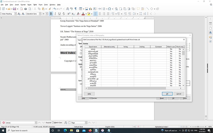

However, I started again as you suggested. I have uploaded a screen capture of the file in edit mode from the index UI. As you can see, the words are there even though they look all screwed up, I think because of the font. Anyway, they all look like they are there. I named the file that I created via Notepad, which is just a simple text editor as far as I know, and named it Word Index.sdi. So, when I opened up the .sdi file from the Edit Index UI, it shows the file with the words. There’s no save button on that UI that I can see though. When I click OK, my document doesn’t get updated. When I then click on Update Index in the Index entity in my document, nothing happens. I’m sorry if I’m really stupid but I still can’t get it to work.

I’m still stuck. I saved the file you sent, pasted it without opening it in the right directory, and renamed it as .txt. When I go to the Index UI, I can’t open it because the UI only allows .sdi files. When I changed it to .sdi, it opened it but it doesn’t have the question marks, but it does have lots of weird characters, which I assume is a character encoding issue since my words are transliterated Sanskrit. However, when I ok it, I didn’t get any index at all. I took a screen shot of what I see in the Edit screen. Then I added the word ‘senses’ at the beginning to see if I got anything. I get an index but only for the word ‘senses’. Thoughts?
Something is broken on your machine (by the way, you didn’t mention your OS name and LO version) because the file you sent opens like a charm on my Linux machine.
If you still have “strange” characters in the list, there is definitely a problem of encoding. The file I sent you is UTF-8. Apparently your Windows expects some other encoding (see @mikekaganski’s comment). The differences may occur on accented letters because these can rarely be translated into 256-character sets. The accented characters are replaced with question marks and this ?-sequence is looked for in your document. This is why “senses” (no accented character, only ASCII) is found and creates an index entry. The sequences with “?” don’t occur in your text and won’t create entries.
