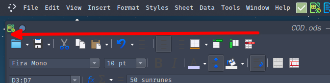

Something has happened the file menu on my writer page and calc pages.
(I assume the remainder of Office as well.)
dislocated_menu
It’s dislocated from the app now, as shown in this screen clip.
The File menu is now in my panel and should be where the red line is.

What happens if you right click another toolbar and select Dock All Toolbars?
That docks the toolbars but not the File menu. I do think we’re in the right area though.
I am not sure it is the right area, maybe this is though, [SOLVED] KDE Plasma: Application menus appear in bottom panel / Applications & Desktop Environments / Arch Linux Forums
Thanks for your help, the latter especially. I recorded that in my notes.
I finally used Timeshift to reset things. Thanks again :)P
