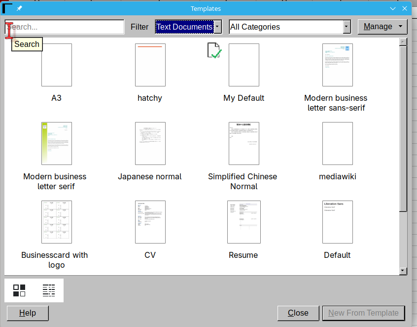

Follow the Modifying a Default Template instructions in the link I gave to edit your default style. when you open the template manager, the current default template will be indicated by a green tick; in my case I have created an additional template to act as default.
Right click on the ticked template to edit it; this will open the normal styles panel and allow you to edit any of the styles in the template.
