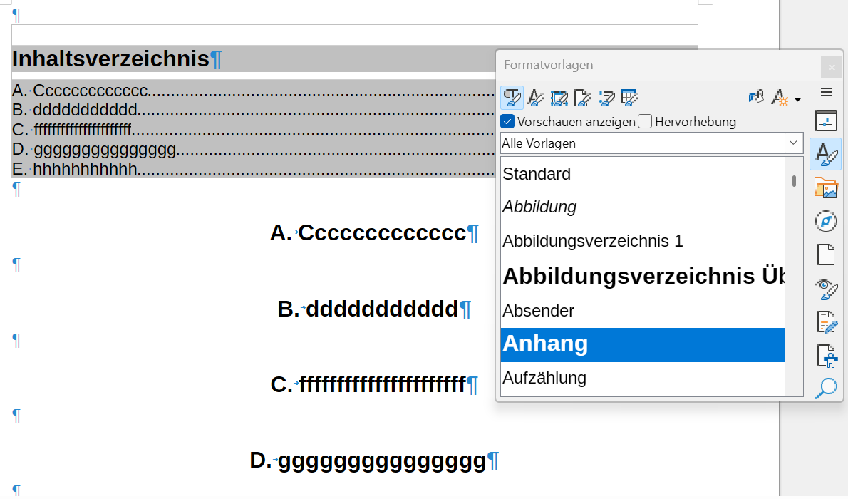

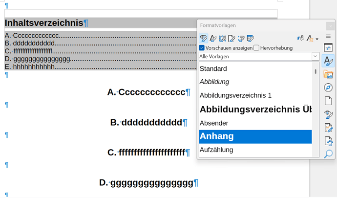

If you specify a list within the “Appendix” paragraph style, it works.
I look at built-in Appendix as it is configured from the factory:
  • formatting is different from Heading n
    Alignment is Center while all others are Left.
  • it is not an “outline” style
    It is attached to no outline level.
  • anyway it cannot by handled by Tools->`Heading Numbering* (unless you replace one level there by Appendix)
  • it has no variant depending on outline level
If you want both Heading n and Appendix in the TOC and you don’t assign an outline level to Appendix, you must tick Additional styles to include it in the TOC configuration dialog.
I’d rather consider that Appendix is some kind of “ancestor” for a to-be-defined family of Appendix n styles, the same as Heading is the ancestor of all Heading n. But even in this case, I question the usefulness of built-in Appendix because Heading can also be used as the ancestor of all Appendix n.
