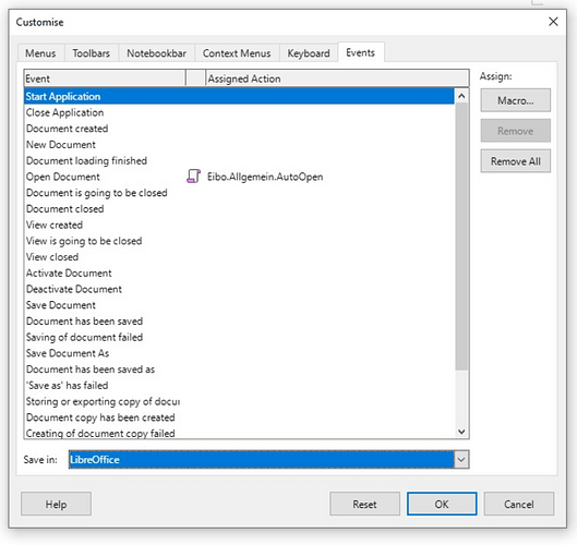

As regular users have no write access to the installation path putting our companies macros there will suffice, any macro in that place is allowed to run by default. The remaining problem was the customization of the “Open Document” event triggering the yellow “Macros disabled” notification. The first part of the solution to my problem was hiding in plain daylight, this customization may be saved instead of the document in the LibreOffice configuration. A macro attached to “Open Document” will run with no further configuration while having “Macro Security” at very high, if it is saved in this way.
The second part of the solution was finding a way to run the document specific AutoOpen macro. In our setup there are a set of macros for every template, each bundled in a module of the same name. I only needed a way to circumvent errors if some template would not need a “Document Open” event and thus had no AutoOpen in its module. This is my code for this requirement:
Sub AutoOpen(Ereignis)
   On Error Goto X
   Dim script As Object
   script=ThisComponent.ScriptProvider.getScript("vnd.sun.star.script:Eibo." & Ereignis.Source.DocumentProperties.TemplateName & ".AutoOpen?language=Basic&location=application")
   script.invoke( array(Ereignis), array(), array())
 X:
End Sub
With this setup it is possible to get a decent and secure operating environment with strict restrictions and full automization.
