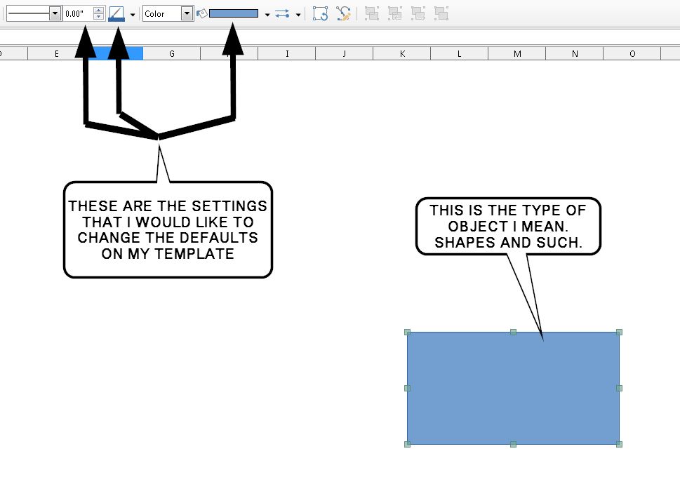

I would like to change the default line thicknesses, line colors and fill color for objects in Calc. How do I do this ?

I do not want to change the fonts in any way. I am looking to change the default line thickness, line color and fill color of objects.

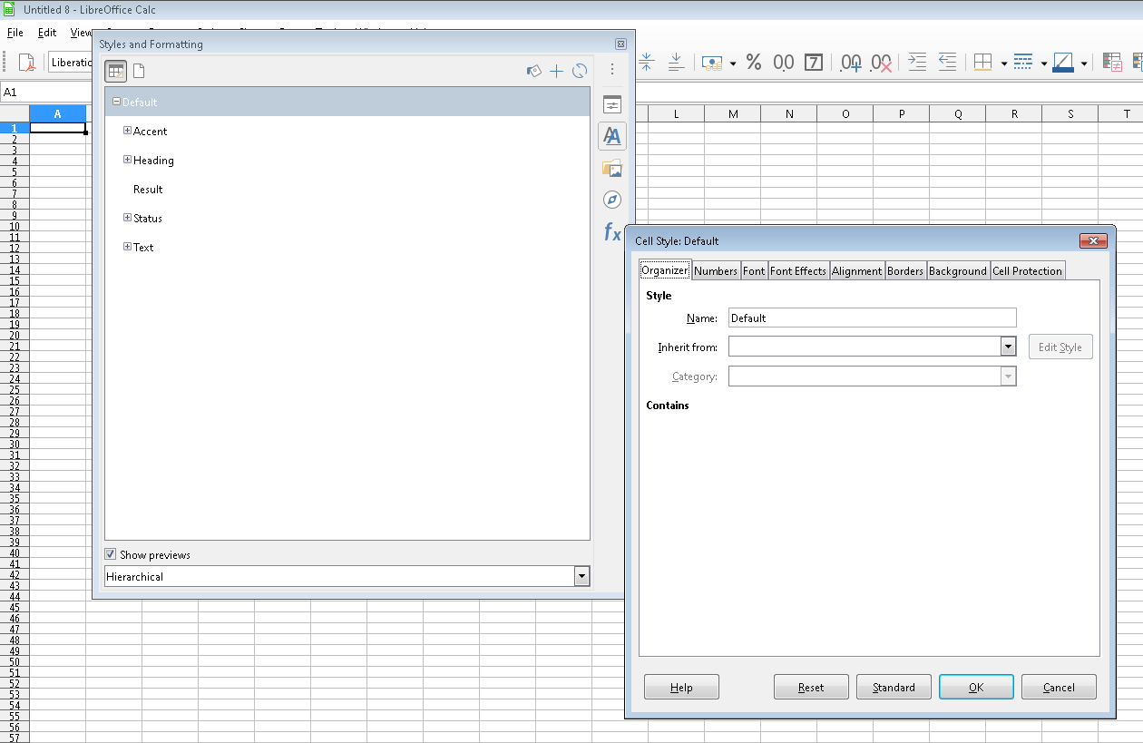

Even if I save a template, for some reason these settings do not stay. I do not see anywhere in the styles for these settings.

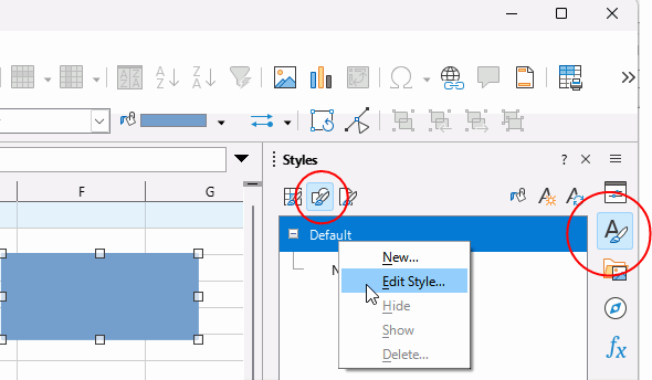

Those are Drawing Objects so in a new blank document:
Note that you can add other drawing styles so you can apply them by just selecting an object and double-clicking the drawing style you want. If the drawing style has been modified by direct formatting then select it and press Ctrl+M to revert it to its defined style.
If you later decide to change the template or stop it being default then click File > Templates > Manage Templates. In the dialogue, right click your default template (has green tick in corner) and select Edit to edit, or Reset Default to set new spreadsheets back to LibreOffice built-in default.
