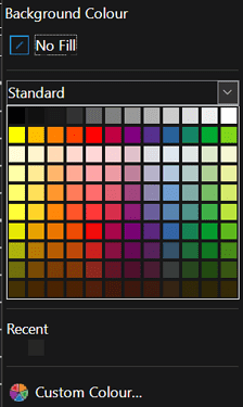

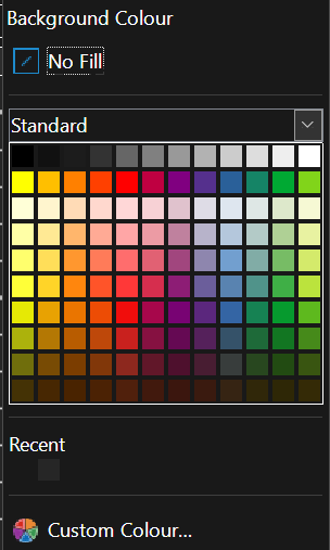

How to change the background colour of a Calc cell to a grandient.
The options for background colour include Custom Colour but not Gradient.
Below, what I want:
