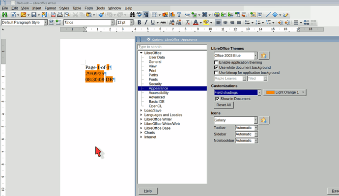

After the software update it seems I can only set my field shadings to grey when I use them on the date and time fields. I used to run these highlighted orange and I would really appreciate if someone would detail to me how to expose and change this setting in Libre Office Writer. I found a setting concerning fields but that did not change the color for me, so if you aren’t sure when you answer, check it on your install and make sure what you are telling me actually works. Thanks.

You change the field shading colour via Tools | Options | LibreOffice | Appearance using the Customisations drop down to choose Field Shadings. You then need to restat LO for the change to take effect.
