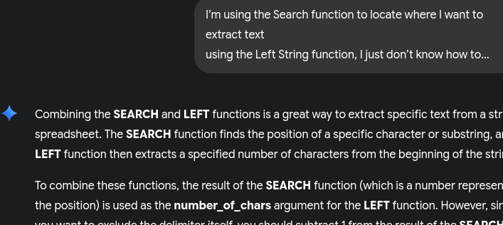

AI says :
→ … Let’s use an example …

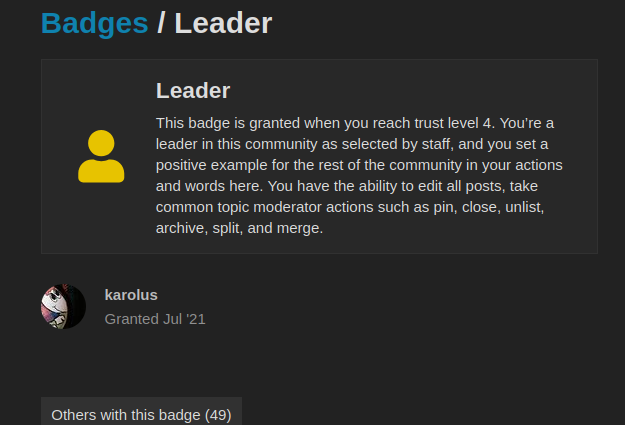

Our “AI troll” has awakened again?! And is spreading its bullshit!?
:thinking: Leader badge on Ask LibreOffice
