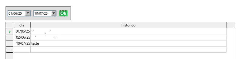

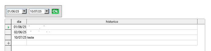

Form filtered for dates between June 1 and today.
This last entry for today I inserted before in the form to check it is editable.

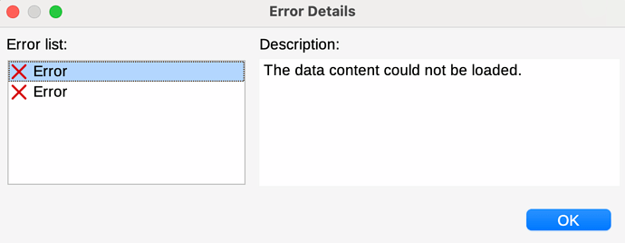

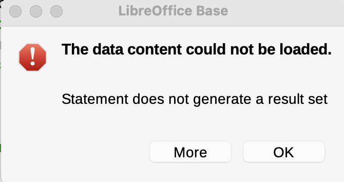

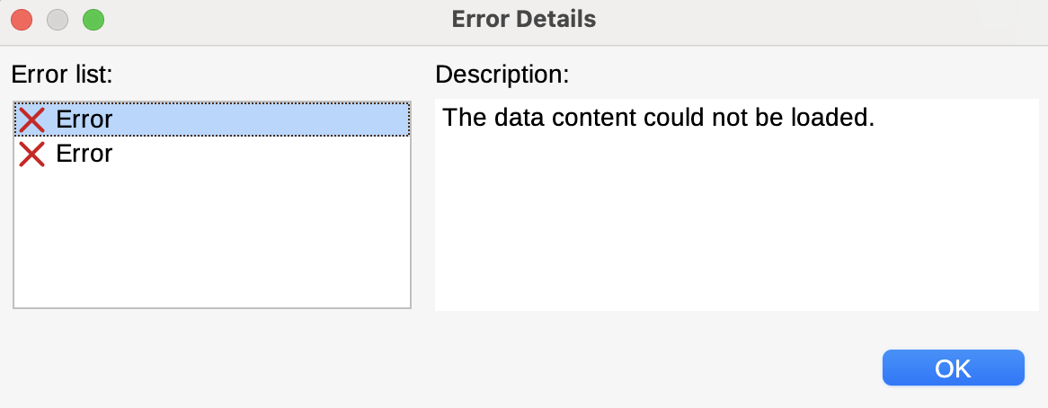

Here is what comes up when I click the OK button:

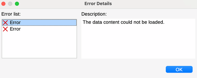

When I click the ‘more’ button I get this:
If you run this exact query in the SQL editor results show up?

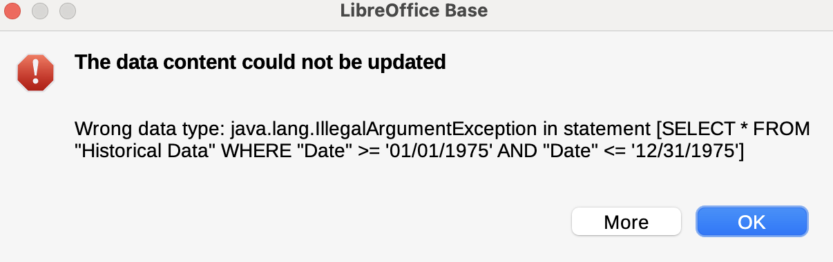

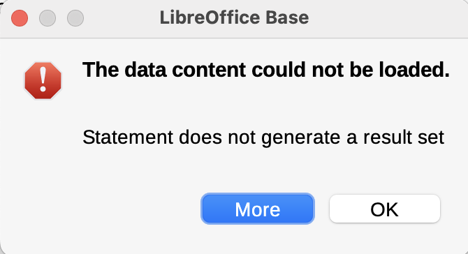

No. I opened the form- “frm-ProgramHistory” and pasted the Macro code in the SQL editor and ran the code. I received the following errors:
Screenshot 2025-07-10 at 8.33.34 PM

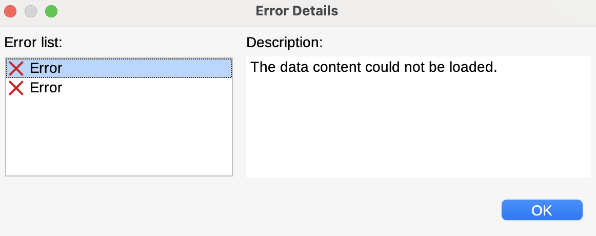

clicked the More button:
closed that message and clicked the OK button from the first error message and got:
Screenshot 2025-07-10 at 8.34.25 PM
Clicked More again and got:
If it helps, this is the entire Macro code:

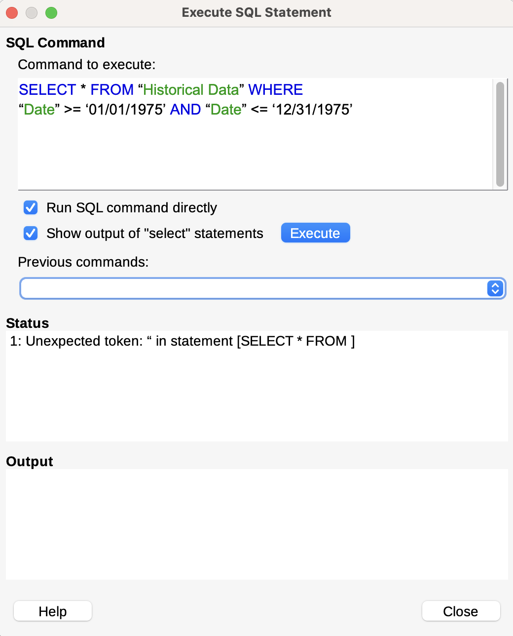

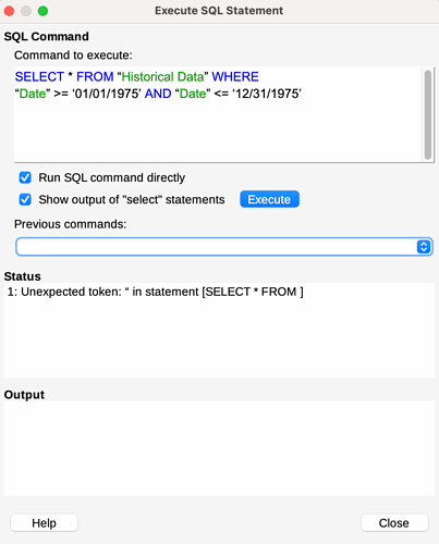

No, I mean run the query in the SQL editor to check the date Format.
Queries > run query in SQL mode:
SELECT * FROM “Historical Data” WHERE
“Date” >= ‘01/01/1975’ AND “Date” <= ‘12/31/1975’
Run to see if it returns the results.

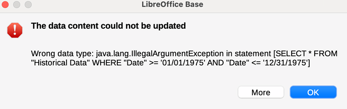

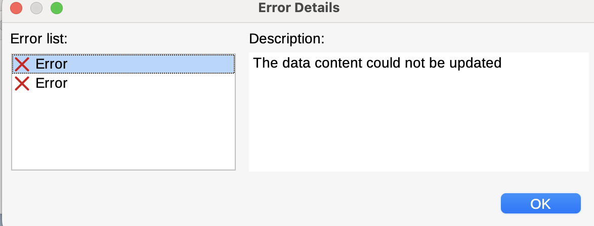

The database is HSQLDB. Here is what I get when I run your code in the SQL editor:
I’sorry: don’t know why.
I think the problem is here as if the query does not work…
You could try using the ISO Format
‘1975-01-01’
‘1975-12-31’
But don’t know, SORRY!
