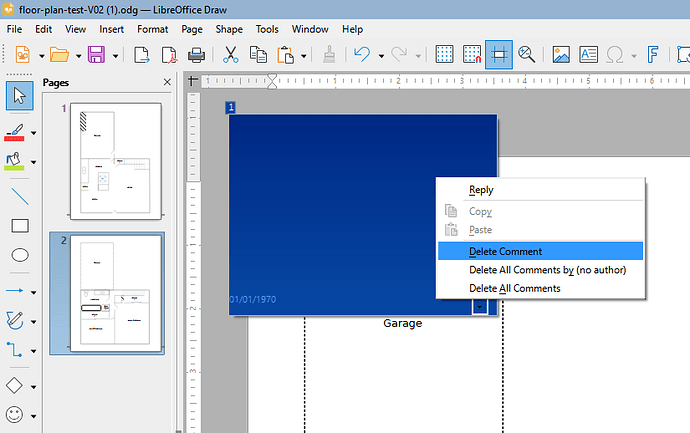

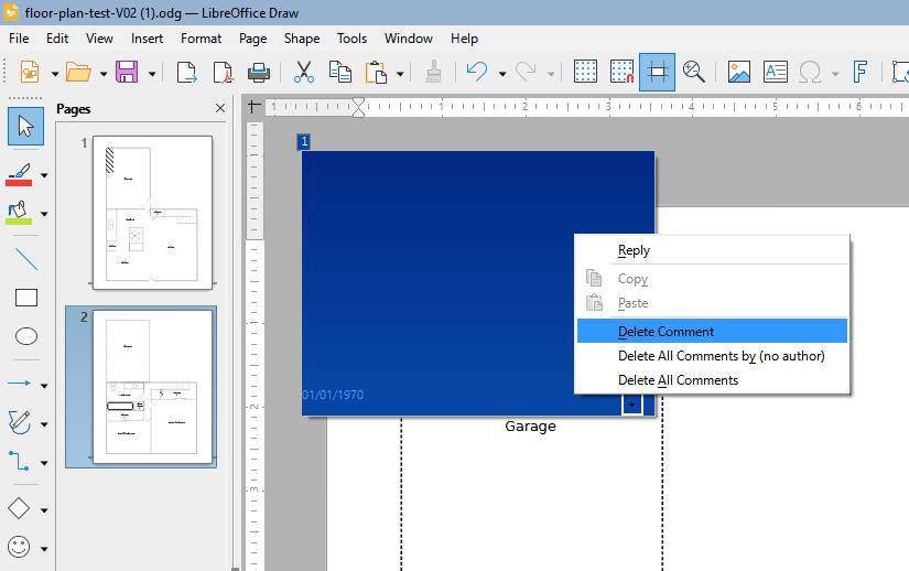

This is a annotation.
1 - Clic on the 1
2 - Right clic on the area of the comment
3 - Select Delete annotation in the menu

Have you click on the comment brand in the drawing area to show the comment edition area and then click with the right button ?
  • Another way to delete the comment is to select the annotation in the navigator and push the Delete key.

  • I can delete the comment in the draw (or annotation in navigator) using any of the two metods .
