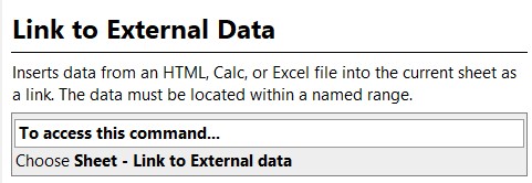

(1) How to link to internal data.
- I can link to external data, using the current spreadsheet filename.
- barring a way to link to internal data, is there a ‘tag’ for this spreadsheet, e.g. ‘self’ or some other equivalent to ‘localhost’?
Do you mean hyperlink() or DDE-Links or direct references?
‘Internal’ would be direct cell references (named ranges)
[I realized, afterwards, is what they would be.]
(And, given Villeroy’s answer, Calc has no such beastie. [Internal.])
External would be other Calc files.
LO_LinkToExternalData

There are no less than 5 different ways linking to external data. The database document is what virtually everybody wants (working with record sets), but nobody uses (somewhat obscure).
Link to external data, URL-Formulas, DDE-Formulas have one common issue. They do not expand and shrink with the record set because they have no notion of record sets.
