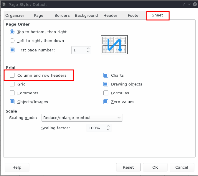

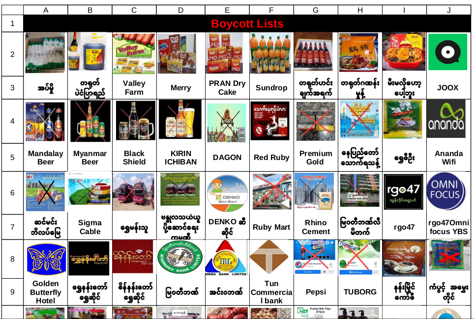

How to fix not to appear the columns 1,2,3... and rows A,B,C below my picture?This is appear after export PDF
Hello,

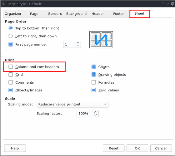

probably you want to disable option Format -> Page...> Tab: Sheet -> Option: [ ] Columnc and row headers (Section: Print).
Hope that helps.
