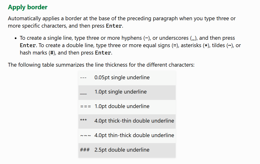

Try:
"---"ENTER
without "
I tried, but this does not work.
Automatic lines in Writer
Apply border

It hasn’t “disappeared”, it was moved to the correct position (under Styles menu, because it’s not a command, but a style). See tdf#124673.
