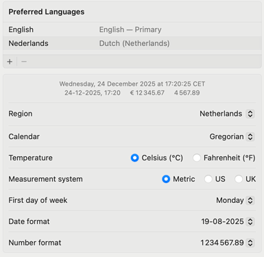

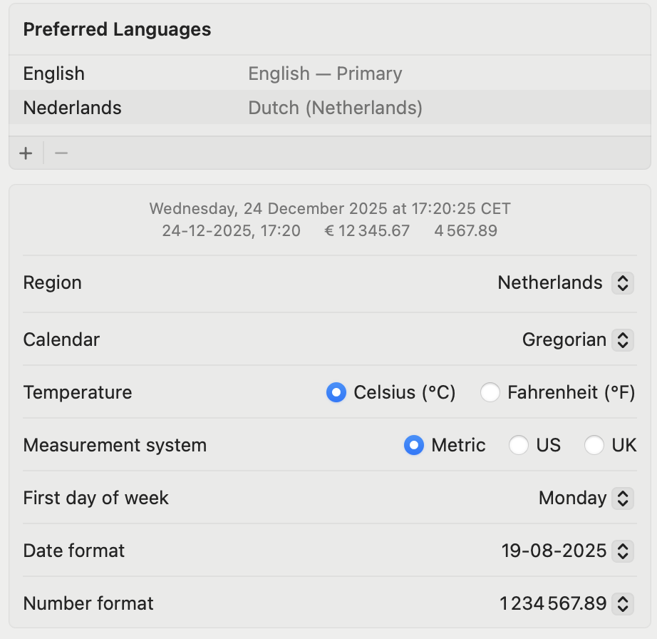

I like to set my default locale to a particular setting, the most important requirements:
  • number format with decimal dots (not comma)
  • date format dd-mm-yyyy (or possibly yyyy-mm-dd)
Ideally, I wish it is possible to set both setting individually, or that LibreOffice follows the locale settings of my operating system (MacOS):
(screenshot of my MacOS locale settings)
Sadly, I only found the Settings > Languages and Locales > General in LibreOffice, which forces me to make changes to all locales (date format, number format, etc.) at the same time.
Is there a way to set the above settings individually? Perhaps with a work-around?
