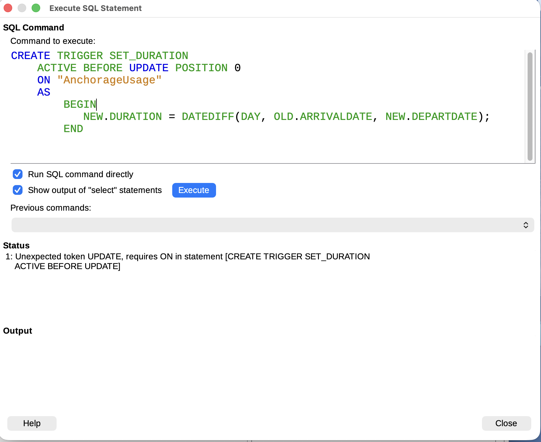

hi. what i uploaded was a re-type of the tools > sql window which included a couple of typos
for some reason I cannot cut or paste out of the tools > sql box. after i select text, then click copy it ignores the selection
your example doesn’t work on my embedded hsqldb, so its probably not supported.
@BCJOHN70,
you cannot use a trigger with an embedded HSQL database, use a split version and upgrade to HSQL 2.x at the same time.
assuming you use the default HSQL 1.8.10 and input your data via a form, a small macro may suffice.
