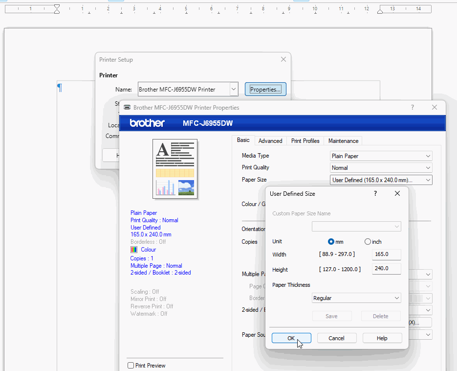

Menu File - Printer Settings?
Unfortunately not
The backup solution is to settle the margin but I would prefer finding a solution thru paper size
It is the usual way. Your printer might demand other settings such as manual feed or to have the special paper size set first for the paper in the tray. The driver might use different units to define the paper size, make sure that you convert correctly or you can accidentally try to specify a size outside the capacity of the printer, that is, too small or too big. You might need to look at the manual for your particular printer to see how to print on custom paper sizes.
