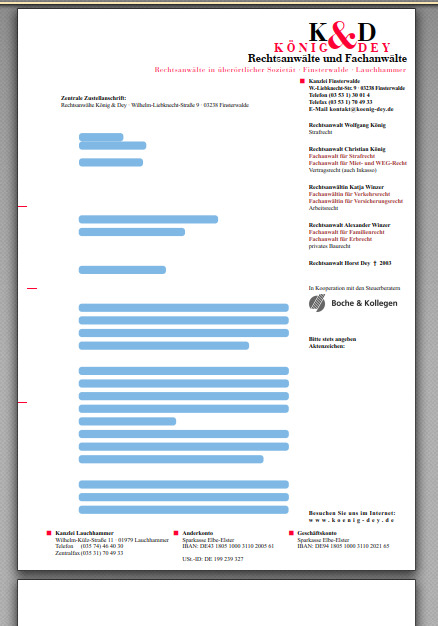

It’s possible to insert the content from the DRAW file into a WRITE file. It’s also possible to change the tranparency of the template page to 100%. I also set the transparency of all OLE objects to 100%. At least all pages but the first are now visible. That’s some progress.
But the first page still shows the letterhead only. The text is still invisible.
I can’t change that by hand every time. That might work. But if it comes to 50+ letters a day it’s to much workflow. I need to make it work with

The parameter multistamp is made for this specific case - only the first page is supposed to get a letterhead. But using background isn’t working either. One time the text covers the letterhead partially. The other time the letterhead covers the text complete and removes all pages after page 1. I guess there is a serious problem creating transparent pdf-files with Libreoffice at all.

If you say so. At least i didn’t find a way to export a transparent pdf-file out of DRAW. And even with WRITER it’s not that easy at all. Maybe it was with Windows 10 / LibreOffice 7.6. I have Windows 11 and LibreOffice 25.2.5.
I found a solution for me. I made a script, which extracts the first page of (transparent) text. I’m using the text as “letterhead” (pdftk background) and the letterhead as “text”. After that I reassamble the file with the “stamped” 1st page. That doesn’t solve the problem but ist a workaround for me. I even use that opportunity to recompress the pdf and make it much smaller.
