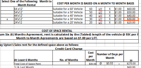

I am trying to achieve the following: I want to select a size marked with an “X” in column C, find the corresponding cost in column J, and have that value appear in cell F50.

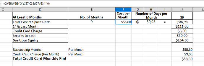

Are you looking for this?
Yes! How did you do it? Please!
Formula in F50: =XLOOKUP("X",C27:C33,J27:J33,"",0)

I noticed that if I move the “X” to a different size in column C, the formula works perfectly. However, if I place the “X” in one of the cash cells below that range, it doesn’t seem to work.
Could you please help me understand why this is happening or how to adjust the formula to include those cells?

@PKG
Why can you use XVERWEIS
but here it is
xverweis
Also, if I try to edit it, to C31 - J31
and back to C33 - J33,
(when tried to include row 40, but this fails because of the grouped rows 34/35 I think)
both results in error #NAME
:grey_question:

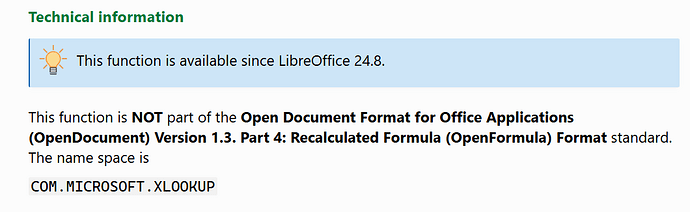

This feature is available from version 24.8.
ReleaseNotes_24.8
It’s your table. How am I supposed to know in which area the formula should work if it’s not described exactly?
:thinking: IF I understand correctly, you want to add the Month to Month option — rows 36 to 40 — to the search.
IF it is this, try
 IFNA(VLOOKUP("x", C27:J31,8,0),0) + IFNA(VLOOKUP("x",C36:J40,8,0),0)

:+1: it was my first try yesterday, and assumed error was because of the grouped rows 34-35.
But of course it was because I don’t have XLOOKUP!

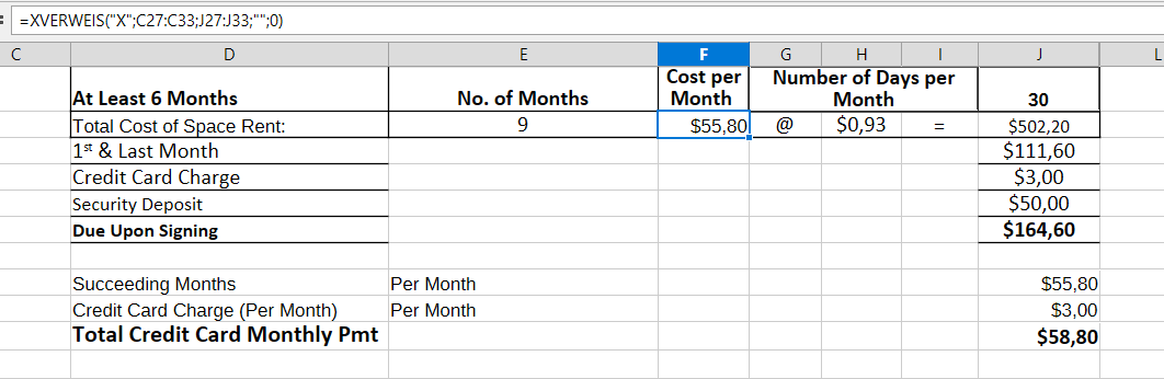

By the way: why at first without editions F50 shows up
com.microsoft.xlookup([…]
result :grey_question:
It seems like value being hard coded in the sheet :thinking:
I can’t explain it, it’s probably some kind of substitute function.
