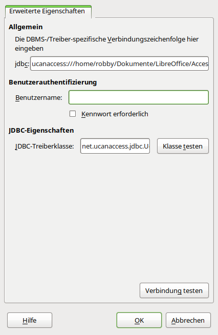

This is how it looks here in properties of the Base file:
There should appear nothing about HSQLDB.
jdbc: will be added automatically when choosing JDBC connection. See screenshot.

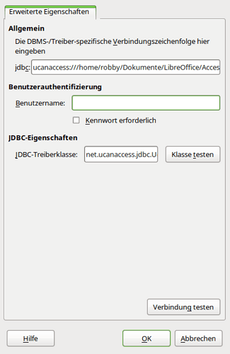

What happens when you click on “Test the connection” (i.e “Verbindung testen” in German)?
Please note that in my case those fields are in two distinct pages of the wizard, the username can be entered after validating the data about the JDBC driver and the connection URL.
The connection was established successfully.
