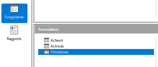

Here is my DB and these forms: “Acteurs”, “Actrices” and “FilmsSeries”.
Forms DB

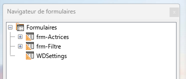

Here, the “Acteurs” form and its 3 main forms: “frm-Acteurs”, “frm-Filtre”. “WDSettings”
From Acteurs
Finally, the “Actrices” form and its 3 main forms: “frm-Actrices”, “frm-Filtre”. “WDSettings”
From Actrices

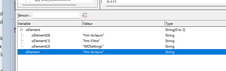

oElement (object variable) places the list of elements corresponding to the names of the three main forms of each of the forms in the database according to the open form.
sElement (text variable) sets the corresponding form name to ElementNames(0).

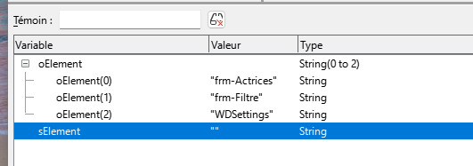

For each form it looks like this:

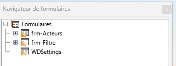

Form 1 (Acteurs): “frm-Acteurs”, “frm-Filtre”. “WDSettings”
Form 2 (Actrices): “frm-Actrices”, “frm-Filtre”. “WDSettings”
Form Actrice (sElement)

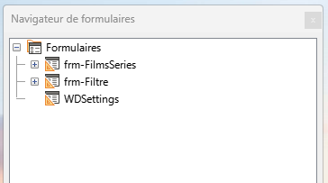

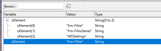

Form 3 (FilmsSeries): “frm-Filtre”, “frm-FilmsSeries”, “WDSettings”
From FilmSeries (sElement)
For the (Acteurs) and (Actrices) forms, in the form’s ElementNames variable, the ElementNames(0) or oElement(0) corresponds to “frm-Acteurs” and “frm-Actrices” respectively. However, for the (FilmsSeries) form, the ElementNames(0) corresponds to “frm-Filtre”.
For what reason in the form “FilmsSeries”, the form “frm-Filtre” is considered to be ElementNames(0)? However, in all three forms, the main forms are arranged in the same order.
From Acteurs

Form FilmsSeries
In the current situation, this requires me to use additional lines of code to check the name contained in the variable (sElement) and act conditionally, which I would not have to do if the ElementNames(0) or sElement was either: “frm-Acteurs”, “frm-Actrices” or “frm-FilmsSeries”.
Is there a way to ensure that for the form (FilmsSeries), the ElementNames(0) or sElement may = “frm-FilmsSeries” and not “frm-Filtre”?

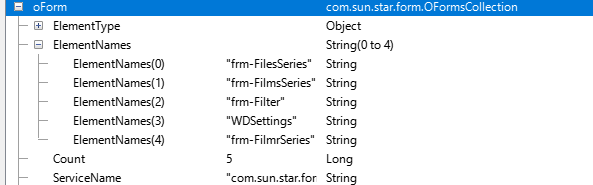

I changed the name of the second form to “frm-Filter” and created two new forms using the same name as “frm-FilmsSeries” and changing just one letter to see how the ElementNames variable would be indexed. Here is the result :
Screen1
Screen 2
I don’t really know what to think about it… And you?

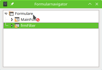

Here a screenshot of my system - form navigator:
grafik
Couldn’t move frmFilter to first position. Could only move it into MainForm. See Bug 155790 for this. I have just created many forms by copying the content from one form document to another form document to get the right order for all elements in form navigator, by tabulator and setting automatic control focus.
In fact, it is possible to make frmFilter first. You have to work around the Bug by placing MainForm in frmFilter (as a subform); move it again by dragging it onto Formulare and it automatically takes the last position regardless of the number of forms present.
