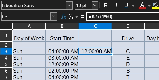

I have 4:00:00 AM in the B2 and I tried to add +(4*60) ie 4 hours to it and the answer is 12:00:00 AM should be 8:00:00 AM.
Screenshot_20260714_165846_RVNC Viewer
i.e. 24 days. Time is a fraction of a day so cell C3 in your screenshot should read =B3+(4*1/24)
The fact that you have 12:00:00 AM displaying instead of 04:00:00 AM indicates that there is some other issue in the sheet, possibly a number or formatting issue. Can you upload a sample using the 7th icon from the left with tooltip Upload

    4*60 formatted as a date-time means 240 days, not 240 minutes. The day is the mandatorily used unit for the calculation of such values.
  • 4 hours is therefore represented by the result of = 4/24 (=1/6).

B2 is empty. So the result in C3 is correct, since 12:00:00 AM is 00:00:00.
Once you understand the *1/24, the formula can be simplified to =B3+4/24.

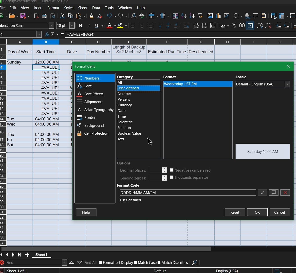

Is this what you want? Note that I have repeated the date/time 3 times in each row, two cells are formatted differently and one uses WEEKDAY function to extract day or week. Formulas are filled to row 31. Just select the Length of Backup (S, M, L) from the drop down selection and enter the Drive letter.
TimeSpan136386EA.ods (13.3 KB)
I don’t have access to Excel anymore.
What I want as an answer:
Sunday 4:00:00AM in A4 and B4 but I’m not even getting the answer formatting or not let alone having the day in column A and the Time in column B. And then I’ll proliferate it down the column.
So apply the formatting that you prefer, for column A apply DDDD, for column B apply HH:MM:SS AM/PM
This seems to work but it’s very different than what the search result suggested. You’re using and actual date and time and formatting them away. Does this work regardless of the actual underlying date would be my question? I don’t want it to be date dependent but day-of-the-weeek and time-of-day dependent. If that makes sense. Maybe I’ m over thinking.
