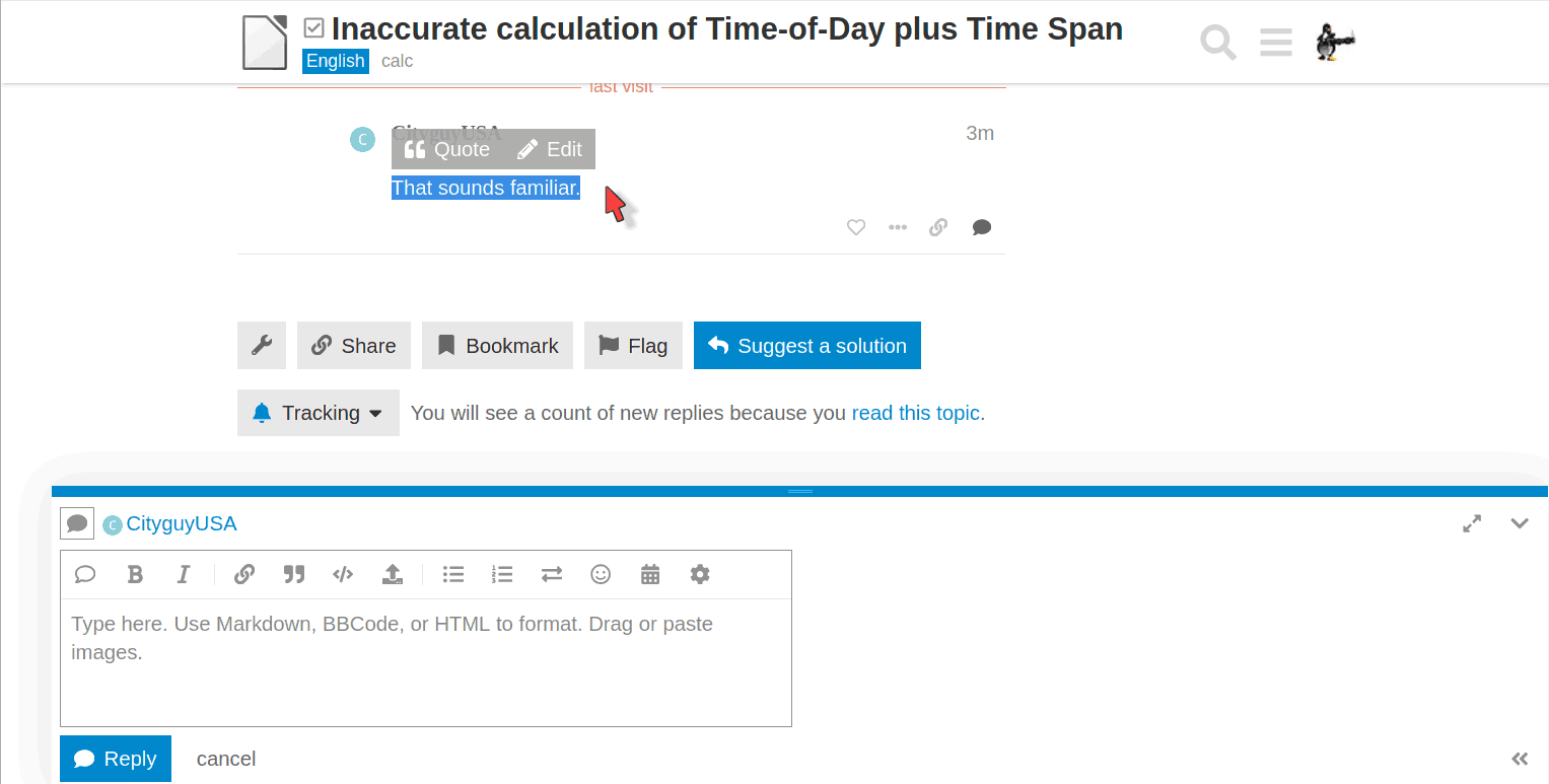

Mark the part you’d like to include before click on the speech-bubble icon.
That sounds familiar.
Open a new comment or solution as appropriate.
Select the text to quote.
Click Quote to add the quote, including a reference to the poster and a link to the post.
