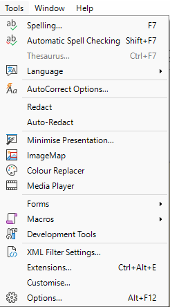

select Tools > Compress Presentation.
EDIT: I now realise that Minimise Presentation is the same thing! My bad
I don’t have that option under Tools. If this is something you can do in LibreOffice, I think that would be really helpful. I didn’t know you could compress them!
