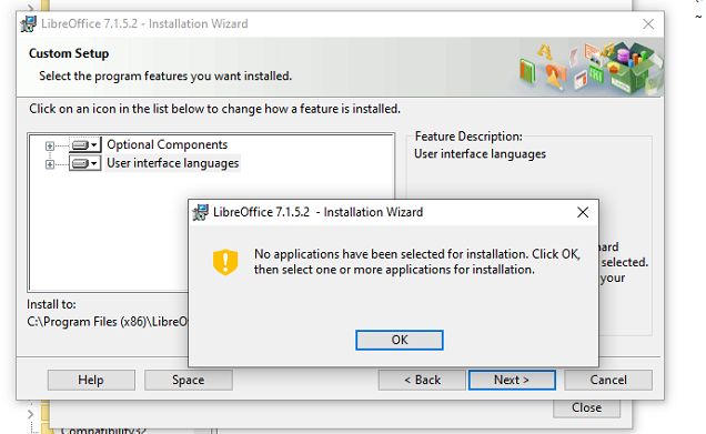

When I run the installer and check “typical” installation the installer runs, the progess bar fills, and the installation finishes “successfully.” I say “successfully” because nothing is actually installed. The LibreOffice program file folders are not created and there is no sign of LibreOffice on the machine.
I have tried running a “custom” installation, but the only options to install are the optional components and languages, but trying to install these produces an error stating “No applications have been selected for installation.”
I have run the microsoft installation troubleshooter, and have done troubleshooting on MSIExec with no progress. Other programs that use .msi files for installation are also working correctly so this seems to be limited to the LibreOffice installer only. I have searched for anyone having the same issue but have not found any kind of fix so any help would be appreciated.

It is very unusual, but I can think of an earlier installation being present on system, with all components removed (this is not easy to achieve, but doable, and might be a result of some third-party tool actions). Did you have LibreOffice on that system earlier?
Anyway, it might help if you create a log (using this FAQ), and provide it for inspection.
