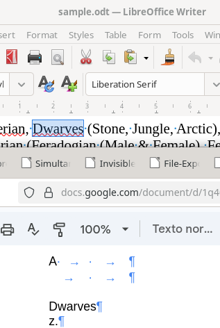

After I’ve finished writing for the day, I copy and paste my text from Writer to a Google Doc so that my early readers can have a look at what’s been done for the day. I’ve noticed that whenever I paste anything from Writer, even if its a few words from the middle of a paragraph to correct existing text in the G-Doc, when it lands in the G-Doc it contains extra formatting that shouldn’t be there. Specifically, when I copy the text back from the G-Doc to Writer with the formatting marks on, I have:
TAB SPACE TAB RETURN
actual copied text RETURN
Granted, not the most egregious thing to deal with, but I’m wondering, where is this coming from? It’s doing it with any docs I’ve tried, both odt and docx, and the extra formatting doesn’t appear when either pasting into the basic text editor or when using Ctrl+Shift+V (which isn’t always possible as I’ll often have multiple sections of text italicized for internal thoughts or other emphasis).

I can reproduce.
It may be a mismanagement of the clipboard content by Google Docs. I tested to paste in a Gmail draft, then copy from there to Google Docs; this works better; anyway, there are manual line breaks added to the text.

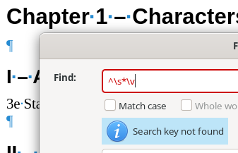

  1. Press Ctrl + H to open the Find and replace dialog.
  2. In the Find field, enter:
    ^\s*\v
  3. Leave the Replace with field completely empty.
  4. Check the box for “Match using regular expressions”.
  5. Click Find to test it on the first occurrence, then click Replace all.
How it works:
The ^\s*\v pattern precisely targets only the phantom paragraphs containing vertical whitespace/break characters generated by LibreOffice, while leaving your actual text paragraphs and heading structures completely untouched.

Here are the results of additional experiments.
In an arbitrary Writer document, select the word And located within a paragraph (the paragraph contains other words as well) and copy it to the clipboard. Then, paste it into a paragraph in a Google Docs document.
Perform the same test with an MS Word document.
Google AI:
Further experiments reveal a deeper architectural issue with how LibreOffice Writer generates CF_HTML compared to Microsoft Word.
The Problem:
If you select just a single word or phrase within a paragraph in LibreOffice Writer and paste it into the middle of a sentence in Google Docs using Ctrl + V, the target sentence gets split into three separate paragraphs.
Why this happens (Under the hood):
Even for a single-word selection, LibreOffice Writer always wraps the clipboard payload in a block-level paragraph tag:
<p lang="en-US" style="...">And</p>
When Google Docs parses this HTML, it sees the <p> tag and treats it as a command to break the existing paragraph and insert a new block.
How MS Word handles this differently:
Microsoft Word is context-aware. If you select a single word inside a paragraph, Word exports it to the clipboard as an inline <span> element (without the <p> wrapper):
<!--StartFragment--><span lang=EN-US style="...">And</span><!--EndFragment-->
Because it is an inline element, Google Docs pastes it perfectly inside the sentence without splitting the paragraph.
Workaround for LibreOffice users:
  • For plain text: Use Ctrl + Shift + V to bypass the HTML wrapper completely.
  • For formatted text (bold/italics): You will have to paste via Ctrl + V and then press Delete twice to re-join the fragmented paragraphs, or open an issue on the LibreOffice tracker to request context-aware CF_HTML generation (similar to MS Word).
