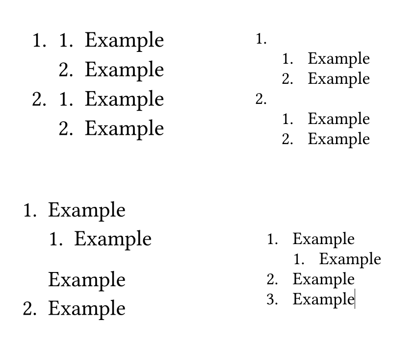

Here are some examples:
Unfortunately, I can only upload one image, so I merged my screenshots into one. On the left, there are the desired list structures, and on the right are the closest approximation I was able to achieve in Writer.
[Top left]
As far as I understand, this is impossible to create. Writer seems to require that the outer “1.” is followed by text. The closest equivalent seems to be:
[Top right]
Unfortunately, this required me to first type something after the outer “1.” and “2.” and then delete it to be able to create the nested lists.
[Bottom left]
It also seems like this is impossible to create. I can write this:
[Bottom right]
But here, the third “Example” is not grouped with the text of the first “Example” and the nested list below it.
Is it somehow possible to create such lists, in a way that I have not been able to find?

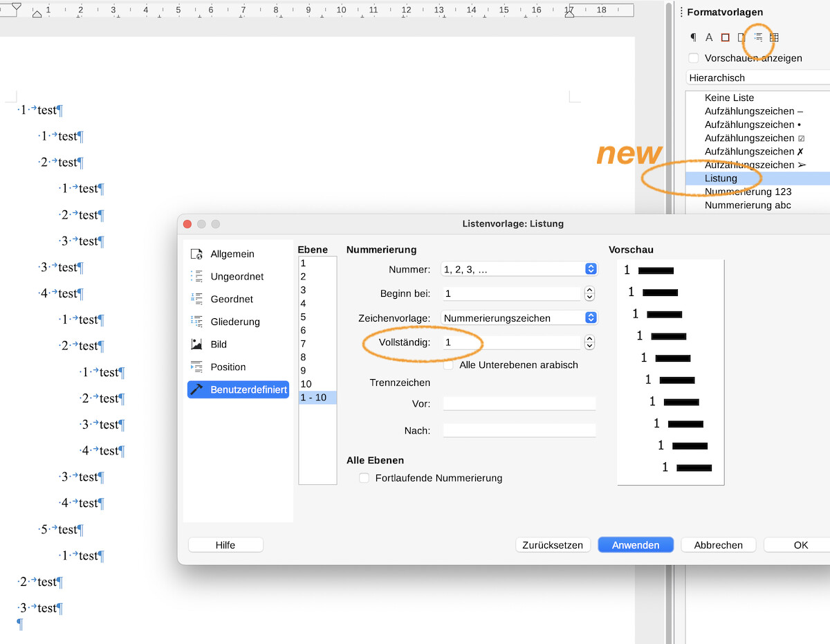

Maybe this is a solution?
CYT_LO-WRiTER_Listing_105128.odt (10.0 KB)
You can change the hierarchy level by level using the TAB key, or by using the key combination TAB + SHiFT keys — in each case at the beginning of the line, i.e., before the list content.

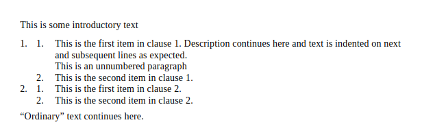

The fundamental tool used in list numbering is a number range counter. When several occurrences appear one after another, they are incremented in “reading order”, i.e. in LTR languages like Western ones left to right then top to bottom. This sequence ordering is kept event through “complex” constructs inside the main flow (consequently, frames are excluded).

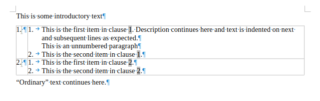

What we need in OP’s example is a way to set a level-1 paragraph item on the same line as a level-2 paragraph item. This is done with a table, resulting in (without any visual hints):
And the structure is revealed in:
Each cell in a table is a “subdocument”. A table is read by Writer row after row (we have a vertical sequence from top to bottom). Within each row, cells are read from left to right (LTR language). Within each cell, we have the usual read order.
This read order controls the incrementation of the list.
In the first column, I insert level-1 items. To prevent spurious erasures of empty paragraphs, I make sure the item contains at least one space. I have use list style Numbering 123 with level-1 modified to align at 0cm, numbering followed by “nothing”. Column width can be adapted to desired spacing between level-1 and level-2 numbers. But don’t forget that level-1 numbers may count several figures. Consequently, don’t narrow too much the left column.
The second column cell contains everything related to the level-1 item. You could allocate one row per sub-clause but it is easier to stuff everything inside a single cell (Writer is not Calc) and the cell will grow to accommodate its contents.
Numbering 123 level-2 has been changed to align left at 0 cm (because level-1 is fully “jailed” in another column), tab stop and indent set at same distance.
AskLOInlineListItems.odt (15.1 KB) is a quick’n’dirty sample document. You need to customise paragraph styles to fit your needs. In particular, I didn’t change the default Table Contents style inside the table. Since this is a “fake” table (used only for layout effect), it does not show tabular data but text which should have been part of the main flow, you could as well apply Body Text inside the table.
Also, Numbering 123 has been applied directly. For full automation, this list style can be associated with a dedicated paragraph style.
