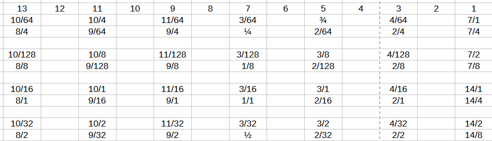

I have produced rows and columns of info that I now would like to rotate through 180 degrees, i.e. top left to bottom right and bottom right to top left.
I can see ‘format/flip’ would allow me to do it one row or column at a time but it is always greyed out no matter what I do. Is it possible to use this to save me re-entering every cell content again?

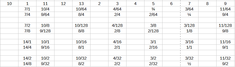

Thanks Wanderer, that almost works. It works with rows of more than 10 rows but with columns ( I have 13) it numbers a descending sort 1,9,8,7,6,5,4,3,2,13,12,11,10. ? So I now have them the right way ‘up’ but not along.
Then your column was set to contain text/strings. They are sorted by first character.
Either set as number before input, or use numbers of same length, like 01, 02, …10, 11… 99
Your added numbering column has been formatted as text, see Value Highlighting on how to see text, numbers and formulas.

I have looked at it again and the data I have is text because I am saving positions of shift register numbers and then positions in the shift register (I am trying to get a large number of leds to light on a board I have stolen from a server unit that contains 64 leds and 14 shift registers) each cell contains two numbers separated with a slash i.e. 14/6 or 5/3 for 14th register 6th box in it so if I called them numbers they would show as fractions.
The row of numbers I am using to sort them are formatted as numbers but if I just highlight the lot and go to data/sort and fill the boxes to sort columns they now sort as 10,1,11,12,13,2,3,4,5,6,7,8,9 ?
I suppose I could just rename everything with a different format like 14-6 but the reason I have asked here is more to find out generally how to flip rows and columns.
