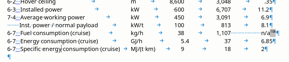

Is this a table, or what?
This table was created from the original WP via my conversion program. I’m calling it a table cuz you can see the automatic decimal alignment. But Navigator doesn’t recognize it as a table or as anything else. Spotlight gives me a hatched blue line on the left that’s full of zeros where the table is. What do they mean? Clearly some formatting or other, but I can’t identify it. And the little blue arrows – sometimes they seem to be plain vanilla tabs but not in this case.

It is not a Writer table. A table is a specific “object” consisting of several sub-documents (cells) arranged on a rectangular grid.
What you have is a collection of text paragraphs.
As I already mentioned in another post, Writer does not use “formatting codes”. Explicit tab stops are defined in the Tab tab of paragraph styles (or on the ruler for direct formatting – to be avoided in “maintained” documents). This is where you specify the stop properties: position and alignment.
It is much more difficult to maintain correct alignment if you mix tabs and spaces (or even text and spaces as is shown in your screenshot for lines 7-4 and the next one). Using a table for tabular data is the recommended approach (for example, the caption in column 2 will automatically wrap on next line if it is too long without overflowing in next columns and messing up the rest of text due to tabs).

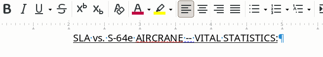

I see it ,thanks. Almost invisible tho, can it be made a bit more robust?
Screenshot_2026-02-12_08-41-52
… the screencap magnifies it. In practice the thing is drawn with one pixel.

I get it. But right now I’m working with what my conversion program gave me. I see that my ‘table’ is really individually direct formatted paragraphs, and I see through a magnifying glass – it’s so small that I have to use my jeweler’s loop and get within an inch of the screen – that within my table the ruler shows an icon that I’m taking to be a decimal tab … and that’s exactly what I’m getting in the ‘table’ so that makes sense. I’ll fiddle with trying to convert it to a legit. table. Right now I’m wanting to be able to see the ruler without a jeweler’s loop.

You are both right. What you have is, technically, a table. It is not listed as a table in the navigator because it is not created as a separate table object. Rather, it is created by using “typewriter style” tabulation stops within text flow.
IOW it is not what the ODF file structure considers a table, but it is a table for practical purposes (conveying information laid out in grid-structured form).
The tab stops used in word processing apps have some options in addition to true typewriter stops:The left aligned is the “standard” true typewriter stop. The others are right aligned, centered, and decimal. The position and type of each stop will be displayed on the ruler at the top of your edit pane.
What to do
How to create a table is up to you. Taste, or what is practical, should dictate the choice.
For some contexts, the table object is better:
  • When tabulated entries exceed column width so they need multiple lines.
  • When you need a drawn grid to clearly distinguish the table “cells”.
For other contexts, the “traditional” tabulation often works better:
  • When you need decimal aligned numbers and the count of decimals may vary.
  • When you have frequent non tabulated lines in between the tabulated ones.
  • When you need a compact output (table objects impose some “padding” between elements; possible to circumvent but can be fiddly).
You can also have a decimal tab stop within a cell of a “structured object table”. The ->| (tabulation) key will skip to next cell when you are inside such a table, so you need to press Ctrl+->| to insert a tab skip inside a table cell.

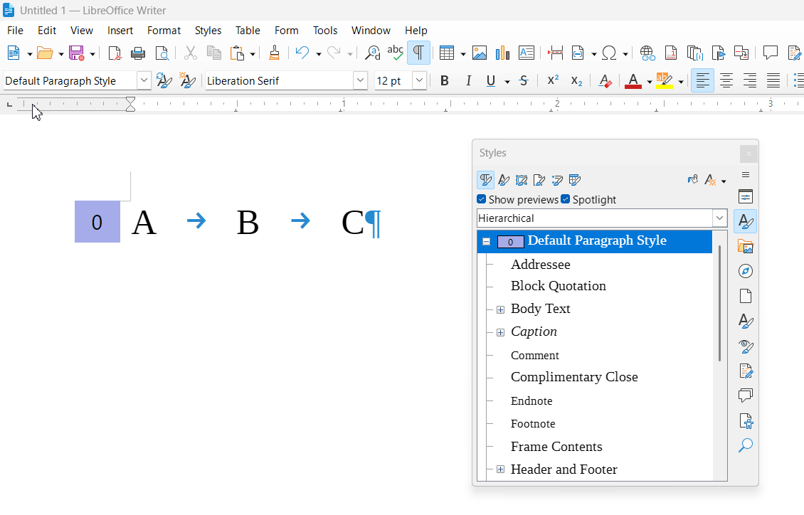

The numbers given by Format-Spotlight-Paragraph styles appear to show how many paragraph styles you are using in your document. Each style used is given a number, and the base style (usually Default style or Text body) is #0.
