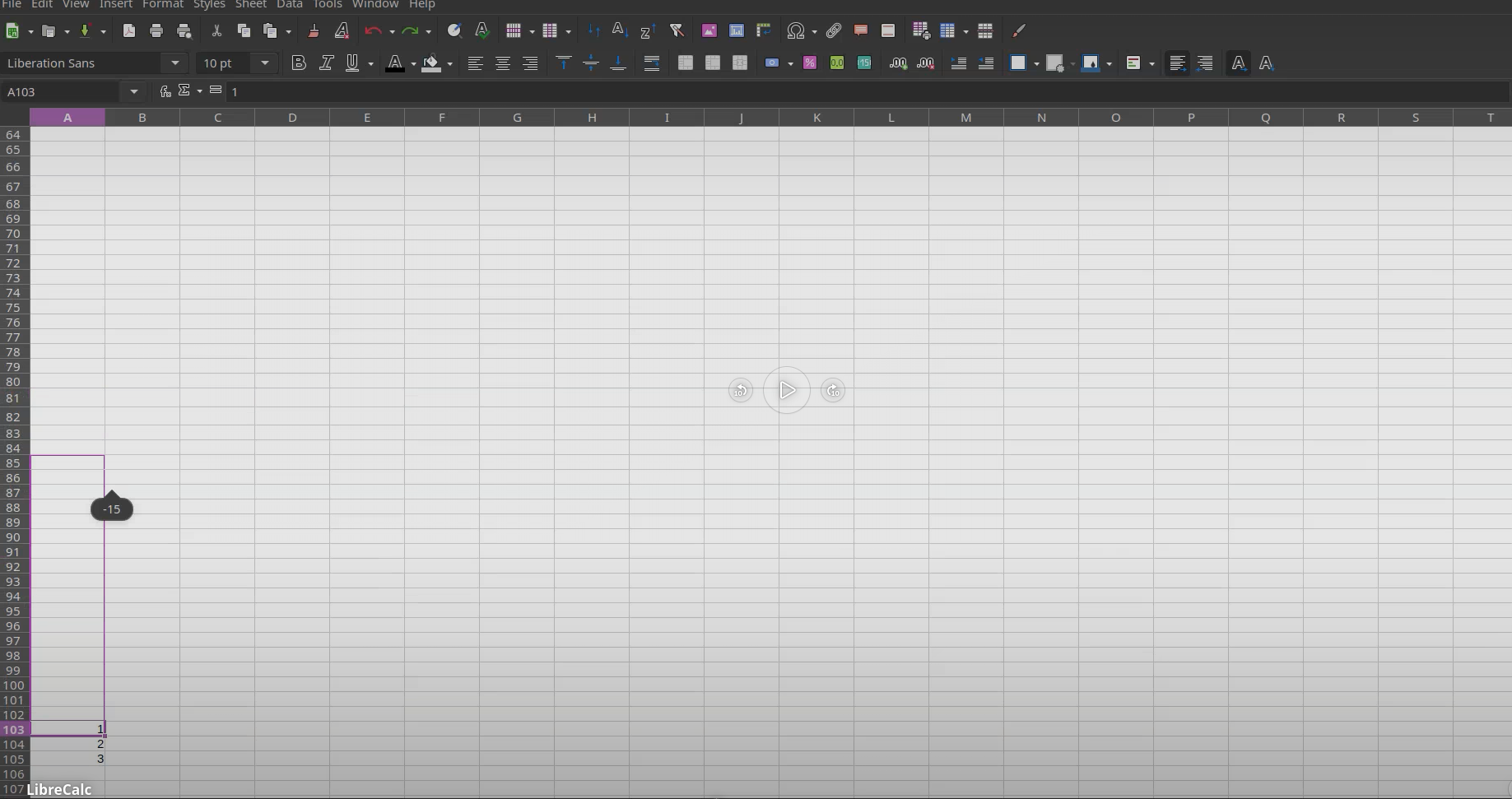

I’m experiencing an issue in LibreOffice Calc v26.2.2.2 on Linux where dragging the fill handle behaves incorrectly.
When I try to drag the fill handle downward to extend values into cells below, the sheet scrolls upward instead, and the fill operation is applied to cells above the starting cell rather than below.
Expected behavior:
Dragging the fill handle downward should extend the data into the cells below.
Actual behavior:
The view scrolls upward during the drag, and the fill is applied upward.
What I’ve tried:
  • Fully removed and reinstalled LibreOffice
  • Cleared user profile (~/.config/libreoffice)
  • Issue still persists
Additional notes:
  • Happens consistently when dragging downward
  • Seems like the drag direction is being interpreted incorrectly
