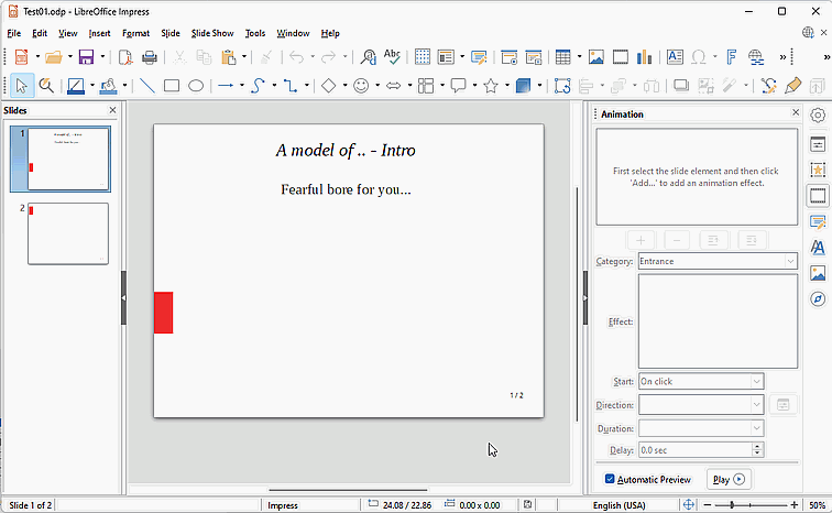

Looks fine to me. There are two slides, helpfully labelled 1/2 (1 of 2) and 2/2. I think that you can’t see the slide pane, click View > Slide pane to toggle visibility.

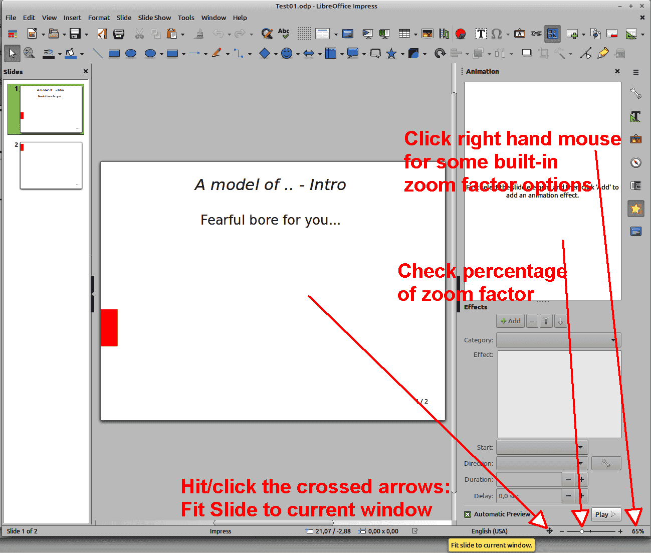

You refer to edit mode, don’t you? See attached screenshot: pointing to zoom factor.

It does not seem to be a problem with zoom, I use ‘Entire Page’.

I did not realize that the lower part of the page (2/2) is a separate slide. Now I have added some text there, but it makes no difference, the show still does not progress to the next file.
