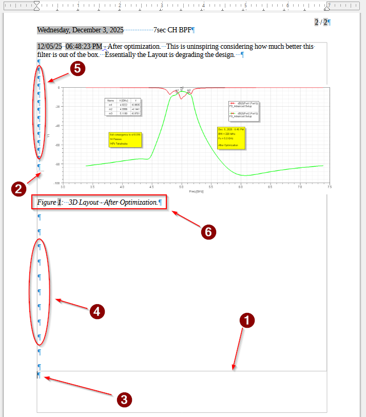

Annotated Screen Capture
I created an annotated screen capture using Computer 1. I labeled many objects with numbers specifically for discussion here.
  1. The miss-aligned rectangle has been annotated with numbers (1) and (2) in my screen capture.
  2. The cluster of carriage returns located at (4) is where the page break did not work (recall that I couldn’t see the mis-aligned rectangle on Computer 1 - otherwise I likely never would have posted here about page breaks).
  3. (3) is where you can place a page break - however anchoring was set to paragraph - resulting in the image following each carriage return (instead of staying in one place)
  4. Both (4) and (5) are multiple carriage returns, very likely, added while attempting to manipulate the embedded image. I’ll try to explain my (dysfunctional?) workflow with images. I’ll embed the image then hit a bunch of carriage returns either above or below the image (depending upon what I want) and then grab & drag the image (usually upward) so that the image sits between the newly created cluster of carriage returns. I do this because, mostly, the image constantly (and annoyingly) drags along with the cursor with every hit of the Enter key - not staying put until I perform what I’ve just described above. I have tried different anchor settings as well as other setting. Currently, I’ve settled on using the anchor with paragraph and setting the image to occupy a space between lines of texts.
In summary the root cause that exhibits the symptom described in this post: page breaks not working (page breaks result in a line break only) is because I am operating within the rectangle annotated in my screen capture as (1) and (2). That is; inserting a page break in area (4) only gives a line break and you don’t seen another page generate - as would normally be the case. You can, however, add a page break to area (3) and the page break indeed works - however the stupid image goes to the next page - because it’s coupled (anchored) to that particular paragraph character.
Now, let’s not forget something - I couldn’t see the mis-aligned rectangles AT ALL on Computer 1. I probably should have taken a screen capture of what I see on Computer 1 for clarity - but for whatever er reason Computer 1 just shows absolutely nothing below the image. Computer 2 clearly shows the mis-aligned rectangles. Is that a setting?
So, the real problem to chase is how to deal with embedding images in Libre Writer - without causing all of these problems.

The “1” in your screenshot is a bottom border of a frame; and the “4” are paragraphs inside that frame. That is the reason of your problem. You can’t have page breaks inside an on-page floating things like frames.

With these clues, your document shows a real disaster in formatting. This has been probably aggravated by your use of the tabbed UI which completely (or so) ignores styles and encourages direct formatting DF (i.e. manual formatting).
Contrary to common belief, DF is not “easy” nor “intuitive”. It requires super expert skills to achieve the desired results. And when it comes to “complex” documents, it opens the door to formatting hell as is exemplified by your sample file.
The sample is already “complex” because it includes an image, which in addition has been captioned. Achieving predictable and stable positioning of such images despite edits requires to drop DF and go for styles exclusively.
You started with an image insertion. There are several ways to do it; they are usually equivalent and don’t bring in their lot of problems. I hope you didn’t already move or resize the image with the mouse because this introduces a very pernicious form of DF which can’t be cleared with common commands (because this DF lives in a different layer).
Then you captioned the image. The caption command creates a frame which size is computed to contain both the image and the text. The image is then anchored to the caption. So far, so good.
A frame is a portion of a page set aside from the main topic to host images or side notes. It can’t extend beyond a page limit. Therefore page breaks inside frames are ignored.
But, as the boundary clues were not displayed, with the cursor at the end of the caption you added text which remained inside the frame and extended it downwards. This text has nothing to do with the caption (or the image) and is part of your main topic. You unknowingly evaded from the main flow to add text to a jailed part which anyway will be clipped at page bottom. And since this is inside a frame, your page breaks are ignored (because a frame never extend beyond page limit).
Also you were not satisfied with your image position and you moved it (upwards) with your mouse. The image is now outside the caption frame. Frames cannot be nested: they don’t interact with each other; they interact only with main text. The caption mechanism gives the illusion of nesting frames only through computation of the outer (caption) frame size and constraining the relative position of the image and anchor. By moving the image, you invalidate the positioning constraint and your image conflicts with your text because it has not the required wrap properties. To compensate for this you added empty paragraphs to flush text below the image.

In this particular case - there’s a certain fussiness with Libre Writer and embedded images.
So, the root cause of the problem is pretty clear now. I’ve added the embedded image, the imbedded image ‘sticks’ to the paragraph - and annoyingly moves downward with each click of the enter/return key. To fix this I’ve been adding a bunch of carriage returns so that I can drag the embedded image upward and out of the way. This is why you see all those carriage returns in my annotated screen capture - I’ve numbered these (4) and (5).
Mostly, that works - but things get exacerbated when I add the Caption. Now I have two rectangle-frames (that are invisible on Computer 1). When I try to move the embedded image upward by dragging the image - the image slides out of the field - and rectangles get mis-aligned (as shown in my screen capture). Since I can’t see the rectangle (on Computer 1) - I might inadvertently add page breaks inside the frame - and hence the symptom described in the title of this post. (i.e. page breaks not working)

The problem in the file you attached is:
  • The image is anchored to the paragraph and to position it you have used paragraph breaks.
  • You have inserted a legend but then you have dragged the image outside the legend frame, so you have on the one hand the image and on the other hand a frame with the legend.
  • This makes it very difficult to reposition the image and the frame whith the caption.
