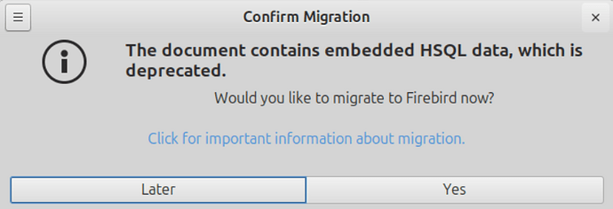

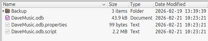

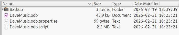

Thanks for followup. I have moved to the Firebird embedded and am MUCH happier. I have attached a screen shot of my files associated with the hsqldb-embedded, as you can see the timestamp of all 3 files are the same, I just opened that files a few minutes ago. I Also get the message to migrate to Firebird.
Do not migrate to Firebird automatically. Most of your queries and forms will fail for one reason or the other. Turn off “experimental features” to avoid the migration prompt. I still have no idea where Backup, DateMusic.odb.properties or DaveMusic.odb.script come from.
Nobody can tell anything about your problem from screenshots. You should upload DaveMusic.odb rather than screenshots.
I did not auto migrate, I selected create a new Firebird embedded db and copied my tables over, that worked pretty good. I had to build my queries and forms from scratch, I never completed my forms in hsqldb anyway so that was not a big deal. The backup files is a moot point now. I am not using hsqldb now. I just uploaded the screen shot to show that there were in fact 3 files (not just the 1) and that they all had the same timestamp. I’m good now. But thanks for the followup, I do appreciate the help.
