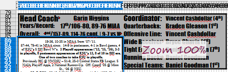

LibreOffice Calc cells format differently on different PCs
The version is 24.8.
The font is the same on both machines - Liberation Serif (the default that comes with Libreoffice) - the thicker black font is called Impact and it is the same on both machines as well.
Cell style parameters are the same.
Display resolution is 1920x1080 which is the recommended for both machines.

I think that he noticed this as well… I’m going to show 4 more screen shots here… this was interesting.
These were all taken from my work laptop. I have highlighted the Superlatives box this time as this is where I noticed it… but the text looks like it is formatted correctly on some zoom levels… but NOT others…
The zoom level is tiny but you can see it in the bottom right. Again, these screen shots are taken by hand so do not pay attention to their actual size.
THIS one looks how I intend.
THIS one does not.
This zoom also doesn’t look right:
But zooming in a little further it is back to OK again…
As you guys have probably guessed, these are spotting boards that I use to call football/basketball games. The #1 thing I’m looking for is that the look on the screen will look the same as it will when I print it (as I actually read the thing in real life and not on a monitor). I typically convert to PDF before printing (my printer likes it a little better that way since it is a tabloid sized cardstock I use which is not a standard size for most printers).
Any thoughts you have on how to make that happen would be great. I would think that the document should look the same at any zoom level…
Appreciate all the eyes on this so far.
There’s nothing you can do. We do some approximations depending of available pixel size (which depends on zoom, as well as on screen resolution); so yes, what you see is not possible to change on your side. It could be possible to improve as a bugfixing, though.
