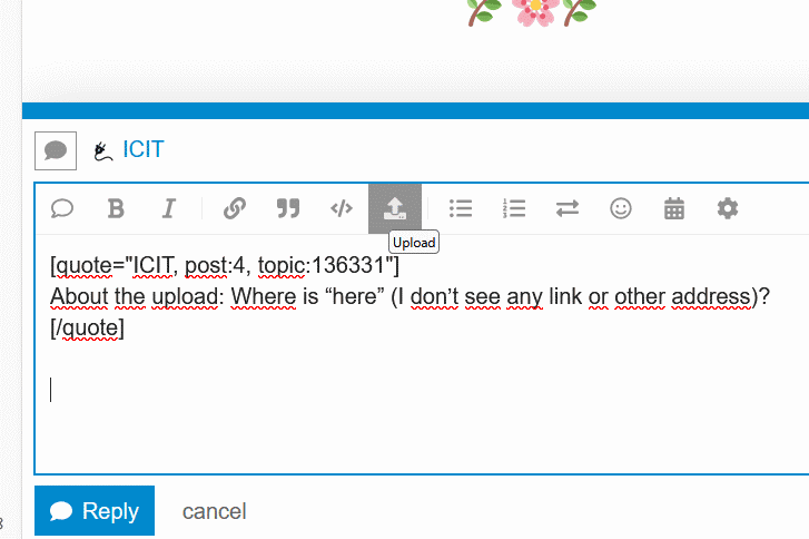

  2. About the upload: Where is “here” (I don’t see any link or other address)?

There is an Upload button in the header of the message edit window.
