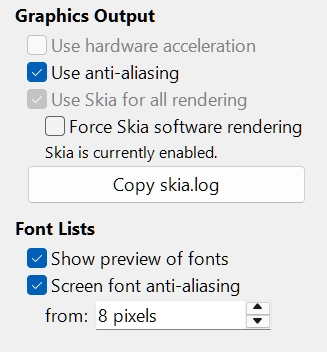

Possibly a graphics issue, from this old question, Opening to last document on firing up LO Writer, it shows “Skia/Vulkan”
An older Win 10 computer is unlikely to support Skia in hardware. Click Tools > Options > LibreOffice > View , tick the box Force Skia software rendering. OK and allow LibreOffice to restart.

Win 11, so I shouldn’t expect that problem, but here’s a screegrab of the dialogue >
+001
I don’t use dark mode. The Check Grammar box is checked. If I do a Grammar check where there is an error, the Text Language is set to English (UK). If there is nothing to correct, the Text Language is set to None.
