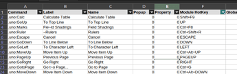

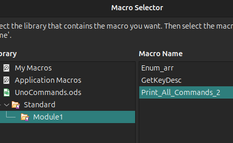

But what I want is a downloadable LO document that I (or anyone) can easily manipulate & reorganize & print on paper for a compact reference. The on-line listing is 10 pages…
you have an .ods from the linked post given by @sokol92 :
you just need to run the embedded macro :
to get populated sheets with the shortcuts :
