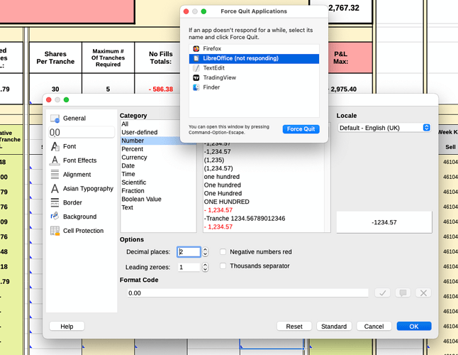

I’m experiencing a frustrating problem with LO Calc freezing when I try to edit an existing Style definition (see attached screenshot) that’s used for conditional formatting.
Before posting a copy of the document, I thought I might just try creating this post as a “hit & run” question, to see if anyone knows anything about this as a previously known problem, which has an easily identifiable and simple solution.

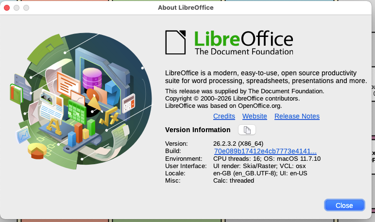

Mac Libre Office version data attached:
Troubleshooting steps taken:
  1. I tried creating a new document and importing the sheet from the broken document that is used for the conditional formatting, and the Style editing works fine.
  2. So, I tried opening LO in Safe Mode with the original broken document. No change. Style editing freezes LO.
  3. Also tried renaming user folder, but same result as above. No change.
Any help anyone can offer is much appreciated
Regards.
CT

I’ve left it saved on the sheet I’ve been having the problem with called “PandL”, and I’ve left the Style editing window open. The two styles that I most recently created are called:
“A Max Profit Highlight 1” and “A Min Profit Highlight 1”.
The particular edit I’m trying on these that freezes with the SPWOD, is to increase the decimal places field to “2” as in my original screenshot above. I get the same behaviour on both my older X86 Mac, and my newer Apple Silicon Mac, so the assumption is the problem is somehow embedded in the document characteristics itself.
Thanks again in advance for any help you can offer.
Regards.
