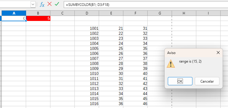

    print "range is (" & upper_1index & ", " & upper_2index & ")"

Sorry, I don’t get it. The range is 16 x 3, why do you get “range is (15,2)”?

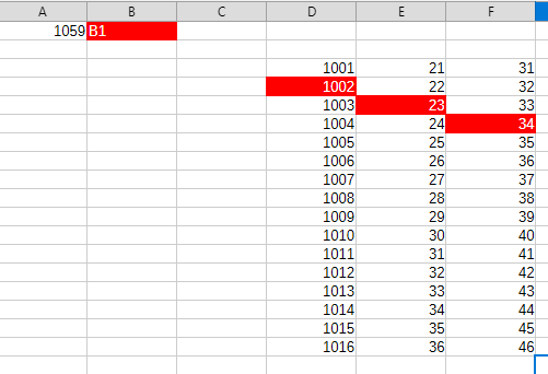

In my “test” I did the trick of inserting “B1” at the reference cell B1
