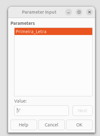

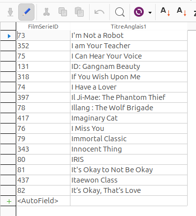

A simpler yet solution with pop-up for the first letter.
Afterwards you could proceed with @Ratslinger solution.
Form’s source:
SELECT "FilmSerieID", "TitreAnglais1" FROM "TFilmsSeries"
WHERE UPPER ( "TitreAnglais1" ) LIKE UPPER ( :Primeira_Letra ) || '%'
ORDER BY UPPER ( "TitreAnglais1" )
ByFirstLetter
Parameter
