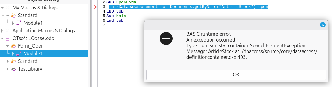

Replaced ¨NameOFMyForm" with “ArticleStock”. Running the macro gives an Error
BASIC runtime error,
Type: com.sun.star.container.NoSuchElementException
Message: ArticleStock at ./dbaccess/source/core/dataaccess/defintioncontainer.css:403
Where is my error?

Yes, a Form “ArticleStock” exists and yes, the macro is stored in the database not ¨My Macros"
I see 3 ArticleStock. Where does '3 ’ come from?
Good catch. Lets guess: The numbers for “ordering” the list of forms, so the actual Name is 3 ArticleStock and needs quoting.
Yes, my attempt to sort forms not in alphabetical order. And yes, the 3 has to be included in naming the form on the button. Thanks!
