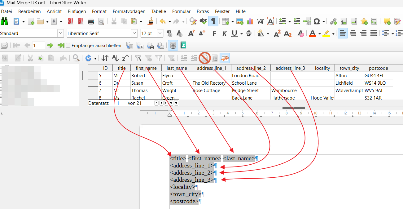

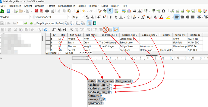

Hasn’t someone told you in the past that you should ignore the Mail Merge Wizard and the address block within it?
Instead, drag the mail merge fields into a frame that you’ve positioned in the document.
Then start printing by pressing Ctrl+P
Print UK TEST.odt (11,1 KB)
